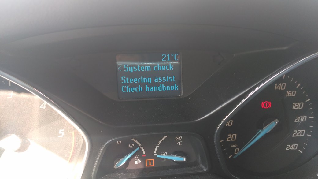

Ahojte,
uz 2x behom 3 tyzdnov mi po nastartovani auta "zamrzol" posilovac a volant. Po vypnuti motora a opatovnom nastartovani to bolo OK. Nemam moc z toho dobry pocit tak by som to co najskor vyriesil. Baterka bola menena minuly rok za origo ford, podla UK for a tomoze byt kotaktom na angle sensore ale nevie kde je, mal by byt niekde pod prednym svetlom...
Do Ford servisu idem buduci tyzden tak uvidim co povie diagnostika
diky

Technical service buletin
11-5-1
LACK OF POWER STEERINGASSIST ON VEHICLE START UP - DTC C102D - BUILT ON OR BEFORE 4/19/2011
Some 2012 Focus vehicles equipped with electric power assisted steering (EPAS) and built on or before 04/19/2011 may exhibit a lack of power steering assist on vehicle start up and may exhibit a diagnostic trouble code (DTC) C102D. The customer will see SteeringAssist Fault Service required message, the steeringwheel icon, and a yellow dot in the instrument cluster, and hear the soft warning chime. Steering assist will remain for that key cycle. For the next key cycle at vehicle startup, the customer will see Steering Loss Stop Safely message, the steering wheel icon, and a red dot in the instrument cluster, and hear the hard warning chime. Steering assist will be removed for that key cycle and all future key cycles.
ACTION:
Reprogram the power steering control module (PSCM) to the latest calibration using IDS release 72.04 and higher or 73.01 and higher. This new calibration is not included in the VCM 2011.5 DVD".
Takze dnes mi vo forde urobili preprogramovanie/update PSCM +kalibracia snimaca riadenia. Tak uvidime

... a Tys tuhle chybu vycetl? na FF2 obcas byvy bludna chyba C1099 (odesly motor), ktera se objevuje behem startovani pri uplne vytocenych kolech

přeji Ti,aby to bylo jen softem a nemusels měnit komplet řízení,jinak jaký máš rok výroby auta? A kupovals auto nový na Slovači?Nebo dovoz?

Rokcnik je 2011, kupovane na Slovensku aj servisovane vo forde, som druhy majitel. Dufam ze to bola len sw chyba. Technik mi povedal ze senzor zle vyhodnotil polohu volantu ...
