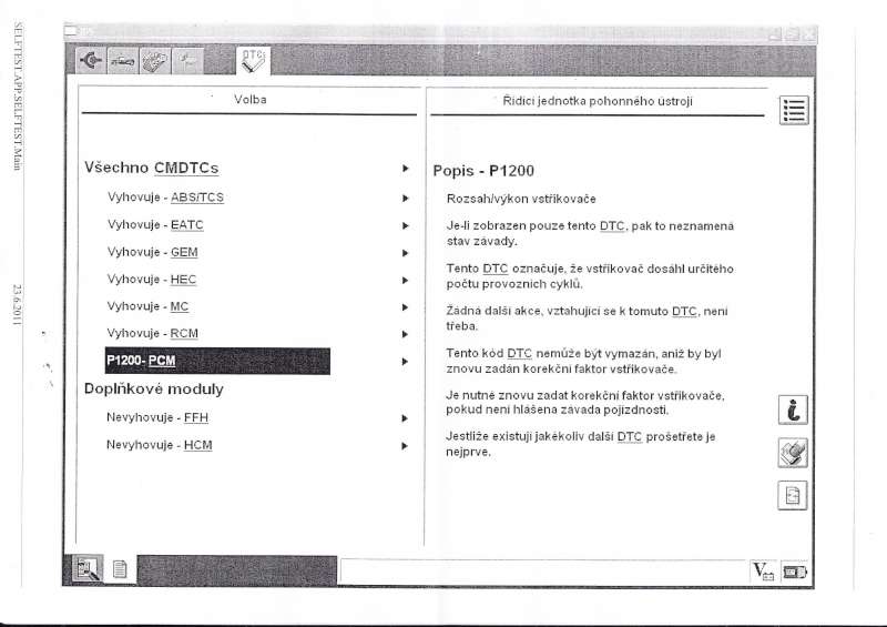

Po dalsom hladani som nasiel celkom podrobnu dokumentaciu TDCi, bolo tam toto:
DTC 1200
Injector Failure
Description: Injector performance failure
Detection: Once one injector reaches 175 000 000 cycles the fault «Injector performance failure» is raised.
Symptoms: No symptoms.
Recovery action: Activates reduced pressure strategy (1200 bar) If customer complains of reduced power/perfomance replace injectors. Reset C2I values.

Hele, nemam to overene v praxi, ale v tomo Delphi manualu
http://forum.fordiag.cz/viewtopic.php?f=15&t=4
(ten Delphi CMNRL.pdf)
pisi:
Proto se ptam cim to bylo kodovane. Ruzne diag. to delaji ruzne a z toho plynou pak ruzne trable.
pisi:
Tedy tato chyba je ciste dana poctem cyklu vstriku. Spravne prekodovani pak musi pomoct."Once one injector reaches 175 000 000 cycles the fault «Injector performance failure» is raised."
