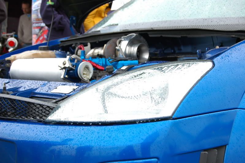

Masívny custom turbo mod, ale fakt BRUTALNY :mrgreen: :twisted: :
http://passionford.com/forum/restoratio ... nside.html
(Ian is quite happy to build an engine of this spec for a price
Contact him by e-mail at: tech@fiestafrenzy.co.uk) :lol: Anyone want one ? :mrgreen:
Slovo autora:
"Originally Posted by Ian Howell:
For those interested in the engine and what I've done, he's the story cut short...
2.3 Ranger 87.5 bore x 95mm stroke
DKE custom crank to reduced to 83.00m stroke
Block liners removed along with most of deck face and replaced with Ductile Iron Items from Darton Sleeves, and bored to 91.00mm.
Custom rods to give a Rod length/stroke ratio of 1.98. Custom pistons for 7.4:1 CR.
Ally main cap ladder remachined to allow fitment of 2" thick ally girdle. Head studs in main stud locations. Head anchorage now by M12 Cummins diesel studs (drilled deeper). Pace dry sump kit.
Top end is a development head by Jim Garrard at CNC heads, valve seats changed for Nibron, custom made Valves, my spec cams and valve train.
Inlet manifold is an early prototype from Cosworth America which I reworked and added the extra 4 injectors into (8x 625cc/m). Custom Fuel rails.
Exh manifold is 321 SS in 1"3/4 bore. Turbo is Turbonetics T72 with P trim turbine and 1.00 A/R housing (spec'd to suit my cams).
It will run on 102 Oct fuel without and help from NoS and should crack 700 without sweating too hard, but if 800 is close by, it may be given one last push
:wink: "
Zlyhal na dyno-brdze. End of story 8)

Paradni pracicka, myslim ale, ze by musel rezat diru do kapoty na tu "malou" turbinu...

Nie, borec to zabudoval do fofo1 (vyzerá to na RS), ale dlhy zivot motor nemal, odisiel na vykonovej brzde a na dalsi projekt kupil EVO - ale predtym ako sa porucalo najprv turbo a potom s novym turbom cely motor, vytlacil vraj bez namahy z toho 500k:
FOFO (bez motora) predal a stalo sa z neho (asi) "bežné" RS-o:
Celá story tu (v EN):http://passionford.com/forum/restoratio ... ide-4.html
